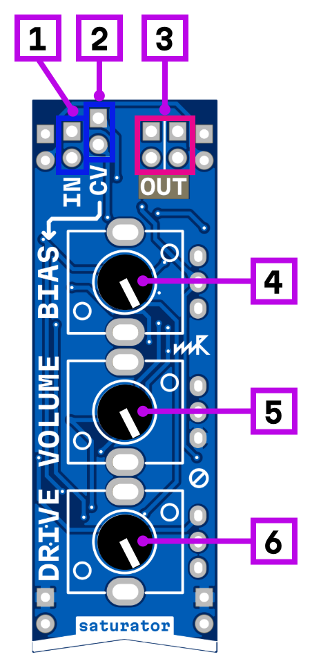

Interface¶
- signal input
- bias CV control
- signal output
- saturation bias
- output volume
- saturation drive control

Drive — controls the intensity of signal distortion.
Bias — alters the signal waveform distortion. In the far-left position, amplitude clipping is applied to the lower half-wave; in the far-right position, it affects the upper half-wave. In the center, distortion is symmetrical for both waveforms.
The bias parameter has a CV input, allowing dynamic modulation of the distortion character with envelopes, LFOs, or other control signals.
Output volume — adjusts the output level after saturation, letting you tame the boosted signal or match levels with the rest of your patch.
