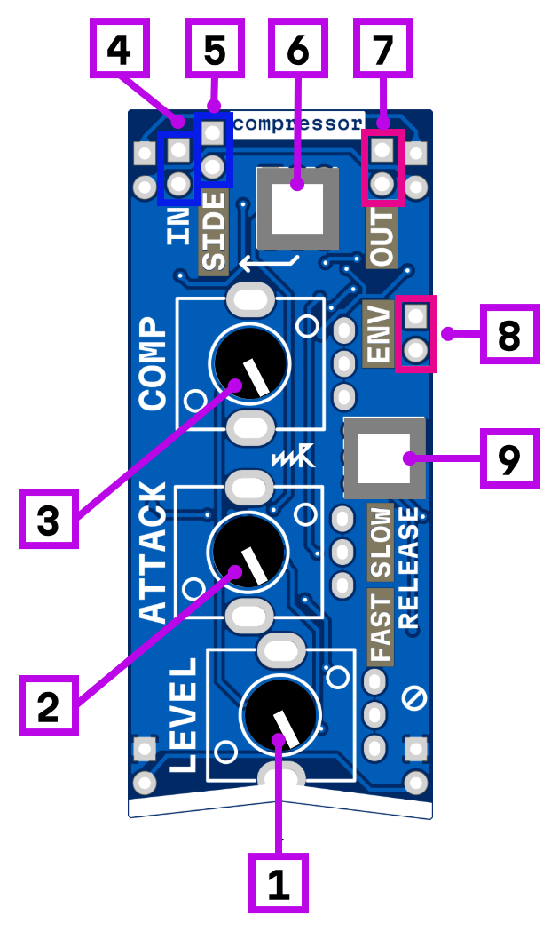

compressor¶
- output level
- attack/speed control
- compression level
- signal input
- sidechain input (works only in sidechain mode)
- sidechain mode switch
- signal output
- envelope follower output (unbuffered)
- slow/fast release mode switch
How it works¶
The compressor reduces the dynamic range of the input signal. The compression level [3] knob controls both threshold and ratio simultaneously — turning it up increases the amount of compression applied.
The attack [2] knob adjusts how quickly the compressor responds to transients. The release mode [9] button toggles between fast and slow release times. The output level [1] knob allows you to compensate for gain reduction.
Sidechain mode¶
When the sidechain button [6] is pressed, the compressor enters sidechain mode. In this mode, the compression envelope is derived from a separate signal fed into the sidechain input [5] instead of the main input [4]. This allows the compressor to be triggered by an external source (e.g., ducking a synth pad with a kick drum).
todo add image for two modes with main inpuit and sidechain input
Envelope output¶
The envelope follower output [8] provides the detected envelope signal, which can be used to control other modules.
