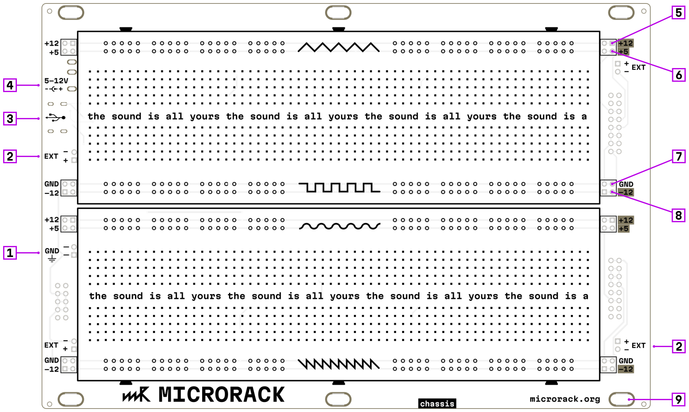

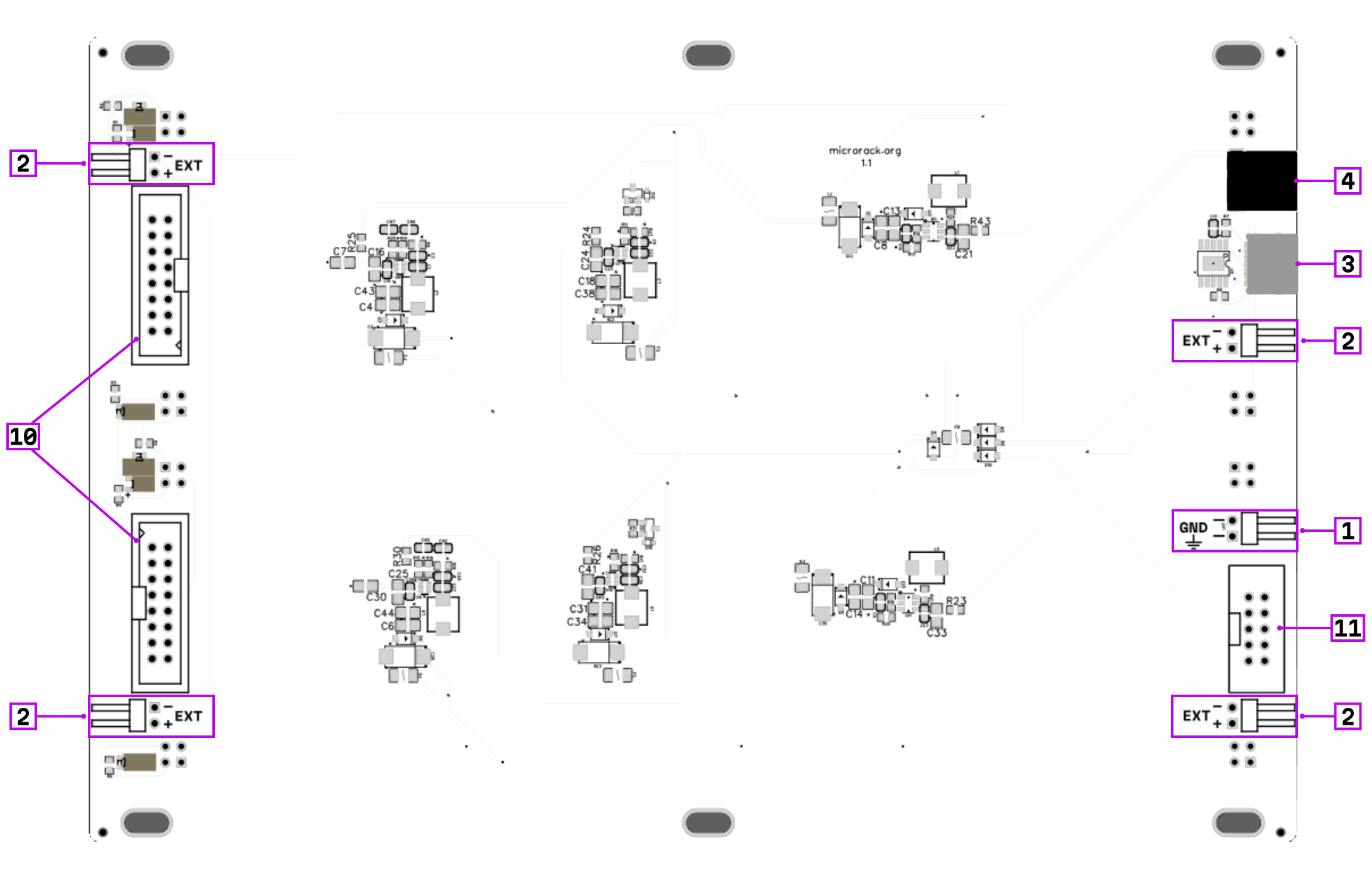

Interface
  1. GND terminals (×2, one for each breadboard)
  2. AUX power input/output: ×4 GND pin and V+ (for chaining chassis and power modules)
  3. USB Type-C power input (PD up to 12V or fast charge)
  4. DC jack power input (5.1 mm × 2.1 mm, 5–12V)
  5. +12V output terminal (for each breadboard) (up to 350 mA)
  6. +5V output pin (for each breadboard) (up to 1 A)
  7. GND rail pin (for each breadboard)
  8. -12V output pin (for each breadboard) (up to 350 mA)
  9. Eurorack mounting holes
  10. Eurorack 16-pin connectors (×2) for providing power to other modules
  11. Eurorack 10-pin connector for powering chassis from Eurorack bus board

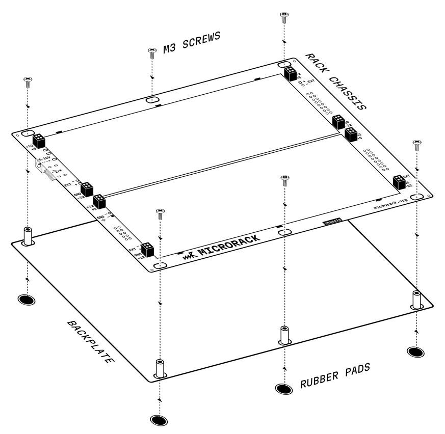

Assembly
The chassis can be used as a standard Eurorack module or as a standalone portable unit. For standalone use secure the backplate with M3 screws and attach rubber pads (do not overtighten the screws).

  1. Position the breadboard on the chassis and align it with markings (do not use adhesive).
  2. Place I/O modules on the edges to connect the breadboard and the chassis.
  3. Power the chassis via the USB‑C, DC jack, or Eurorack connectors.

Eurorack integration
The chassis can be mounted in a standard Eurorack case using the mounting holes. On the bottom side:
  • 10-pin connector — allows the chassis to be powered from a Eurorack bus board
  • 16-pin connectors (×2) — provide power output to other Eurorack modules, allowing you to power additional modules from the chassis
